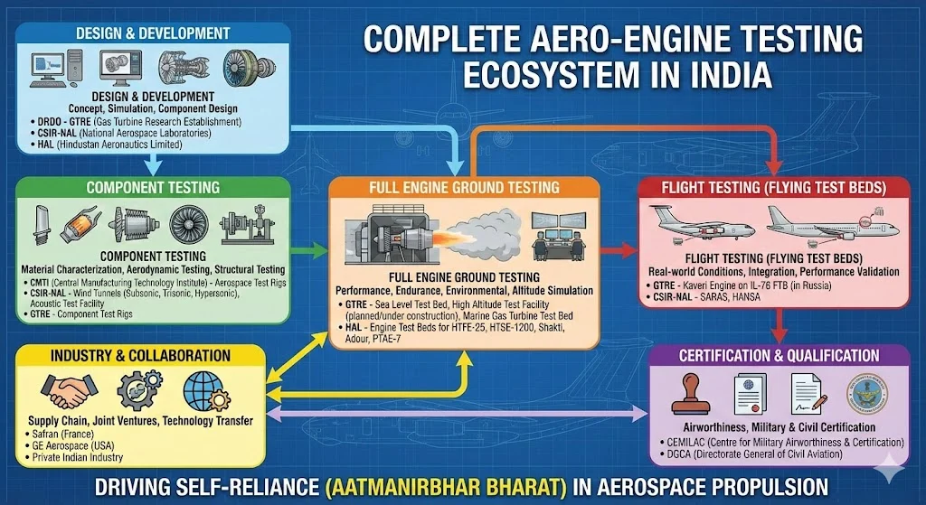

As India approaches the finalisation of a landmark agreement with France to jointly develop a new 120 kN-class aero-engine, the focus has shifted towards rapidly building a comprehensive domestic ecosystem for engine and component testing.
This strategic initiative, supported by French technical expertise—likely involving aerospace major Safran and India’s Gas Turbine Research Establishment (GTRE)—aims to bridge a critical gap in India's pursuit of self-reliance in high-thrust military aviation propulsion.
According to sources close to the programme, this collaboration extends far beyond the mere design and manufacturing of the engine intended for the Advanced Medium Combat Aircraft (AMCA) Mk2.
A primary objective is the creation of end-to-end infrastructure for testing and validation within the country. This capability is viewed as essential not just for the immediate 120 kN engine project, but as a foundational asset for all future indigenous engine programmes, mid-life upgrades, and derivative variants expected in the coming decades.
A cornerstone of this planned ecosystem is the establishment of advanced component-level testing facilities. These centres will be dedicated to the rigorous validation of critical sub-systems, including high-pressure compressors, combustors, turbine blades, and bearings.
By enabling early-stage testing of these components—potentially including advanced single-crystal blade technology—engineers can significantly reduce developmental risks.
This approach is expected to enhance reliability and shorten the iterative design cycles, addressing a specific challenge that has historically delayed Indian engine programmes like the Kaveri.
The partnership also envisages the development of state-of-the-art Altitude Test Facilities (ATF) with French support.
These sophisticated facilities are designed to simulate high-altitude environments and diverse flight conditions on the ground, allowing for the assessment of engine operability, stability, and performance across the entire flight envelope.
Historically, the lack of a domestic ATF forced India to rely on foreign facilities in Russia or Europe, a dependency that often resulted in schedule delays and limited the flexibility of design teams.
In parallel, a robust ground test infrastructure is being planned to support heavy-duty endurance runs, fuel efficiency analysis, and thrust validation.
These ground-based trials serve as the backbone of the certification process, facilitating long-duration testing under strictly controlled conditions before the engine is ever cleared for actual flight testing.
This ensures that any potential faults can be diagnosed and rectified without the risks associated with airborne trials.
Furthermore, the ecosystem will be bolstered by specialised structural and environmental testing units.
Structural testing will focus on verifying the mechanical integrity of the engine assembly under extreme physical loads, vibrations, and thermal stresses.
Simultaneously, environmental testing will subject the engine to harsh operational realities, such as extreme temperatures, humidity, salt-laden maritime air, and sand or dust ingestion.
This is particularly vital for ensuring the engine’s robustness across India’s varied operating environments, from the scorching deserts of Rajasthan to the high-altitude airfields of Ladakh.
Finally, characteristic testing will be central to mapping the engine's precise performance parameters. This includes defining thrust curves, specific fuel consumption, and transient responses.
Such data is critical for refining the Full Authority Digital Engine Control (FADEC) laws and ensuring the engine behaves predictably across all regimes.
By establishing these capabilities domestically, India is effectively securing its long-term strategic autonomy in the aerospace sector.
