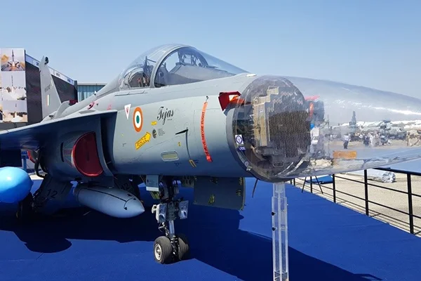

The development of India’s indigenous aerial combat capabilities is poised for a significant leap as the Electronics & Radar Development Establishment (LRDE) gears up to commence critical testing of the Uttam Mk2 Active Electronically Scanned Array (AESA) radar.
This advanced sensor system will serve as the primary eyes for the highly anticipated Tejas Mk2 fighter aircraft, which is on schedule to initiate flight testing in 2027.
According to emerging reports, the Uttam Mk2 has formally entered its ground-testing phase. This development represents a crucial junction in the nation's strategic roadmap to equip its air combat fleet with state-of-the-art, domestically produced radar technology.

A key feature of this variant is its "swashplate-enabled" design. This mechanical innovation allows the radar antenna to be physically repositioned, providing a field-of-view exceeding 100 degrees and a search volume of up to 140 degrees.
