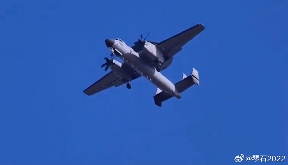

China's Airborne Solution - The KJ-600​
Meanwhile, China forged ahead with its domestic AEW&C solution, the KJ-600. This high-wing, twin-propeller aircraft carries a large dorsal radome suggesting substantial radar power.
Built explicitly for the PLAN's Type 003 carriers (which do use CATOBAR launch systems), the KJ-600 promises significantly enhanced situational awareness for Chinese naval operations.
