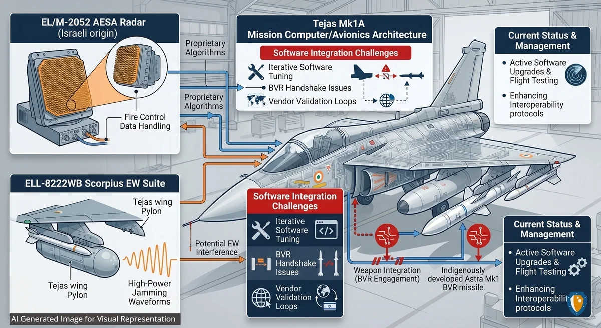

The Light Combat Aircraft (LCA) Tejas Mk1A programme, a cornerstone of India's modern air defence strategy, is currently navigating complex technical hurdles.
Recent reports indicate that the aeronautical establishment is working to resolve software integration issues involving the Israeli-origin ELTA Systems EL/M-2052 Active Electronically Scanned Array (AESA) radar and the ELL-8222WB (Scorpius-SP) electronic warfare (EW) suite.
While these systems bring formidable capabilities, pairing them with the indigenous fighter platform and Indian-made weapons has proven to be a demanding software engineering task.
The primary obstacle lies in making the Israeli radar communicate flawlessly with domestic weaponry, particularly the Astra Mk1 Beyond Visual Range (BVR) air-to-air missile.
The EL/M-2052 radar uses proprietary, heavily guarded computer algorithms to track targets and manage fire-control data.
For a BVR missile to accurately strike an enemy aircraft from miles away, there must be a seamless digital "handshake" between the fighter's radar and the missile's onboard seeker.
Achieving this level of interoperability requires constant software modifications, followed by rigorous testing and validation by the Israeli vendors.
Furthermore, engineers are addressing signal clashes between the AESA radar and the Scorpius EW pod.
The electronic warfare suite is designed to emit high-power jamming signals to confuse enemy air defences and incoming missiles.
However, if these powerful signals are not perfectly synchronised with the aircraft's own radar, they can unintentionally interfere with the jet's sensitive receivers.
Resolving this requires complex waveform management to ensure both systems can operate simultaneously without "blinding" each other.
Despite these challenges, the Israeli systems are highly mature and far from experimental.
The EL/M-2052 is a reliable, combat-tested radar that was partly funded by India for the Jaguar DARIN-III upgrade programme, where it functions successfully.
Similarly, the Scorpius EW family is a trusted system used widely around the world, including on Indian Su-30MKI fighters and various international F-16 fleets.
The radar was chosen for the Tejas Mk1A specifically because of this strong track record, which offered a faster route to upgrading the jet's combat capabilities compared to waiting for newer domestic alternatives.
The root of the delay lies in adapting an off-the-shelf foreign system to a unique domestic airframe.
The backend software of ELTA's systems was originally designed for different fighter jets with different specifications.
Adapting them to the Tejas Mk1A—which has its own specific avionics architecture, power limitations, and cooling capacities—requires deep customisation.
Because the software's source code is tightly controlled by the manufacturer, Indian engineers cannot make the changes themselves; they must rely on ELTA's personnel.
This reliance on a foreign vendor makes the timeline vulnerable to external delays, including export clearances and the ongoing geopolitical conflict in the Middle East, which has inevitably affected the availability and response times of Israeli technical support teams.
These integration efforts are a standard, albeit time-consuming, phase of modern fighter development.
The Indian aerospace sector is actively managing these issues through continuous software patches and flight trials.
To provide broader context, under Hindustan Aeronautics Limited's (HAL) Rs 48,000-crore contract for 83 Tejas Mk1A fighters, only the initial batches are slated to feature this Israeli suite.
Subsequent batches will be equipped with the fully indigenous DRDO Uttam AESA radar and domestic EW systems.
Ultimately, resolving these software hurdles will deliver a highly capable Tejas Mk1A while providing invaluable integration experience that will strengthen India's self-reliant defence ecosystem.
