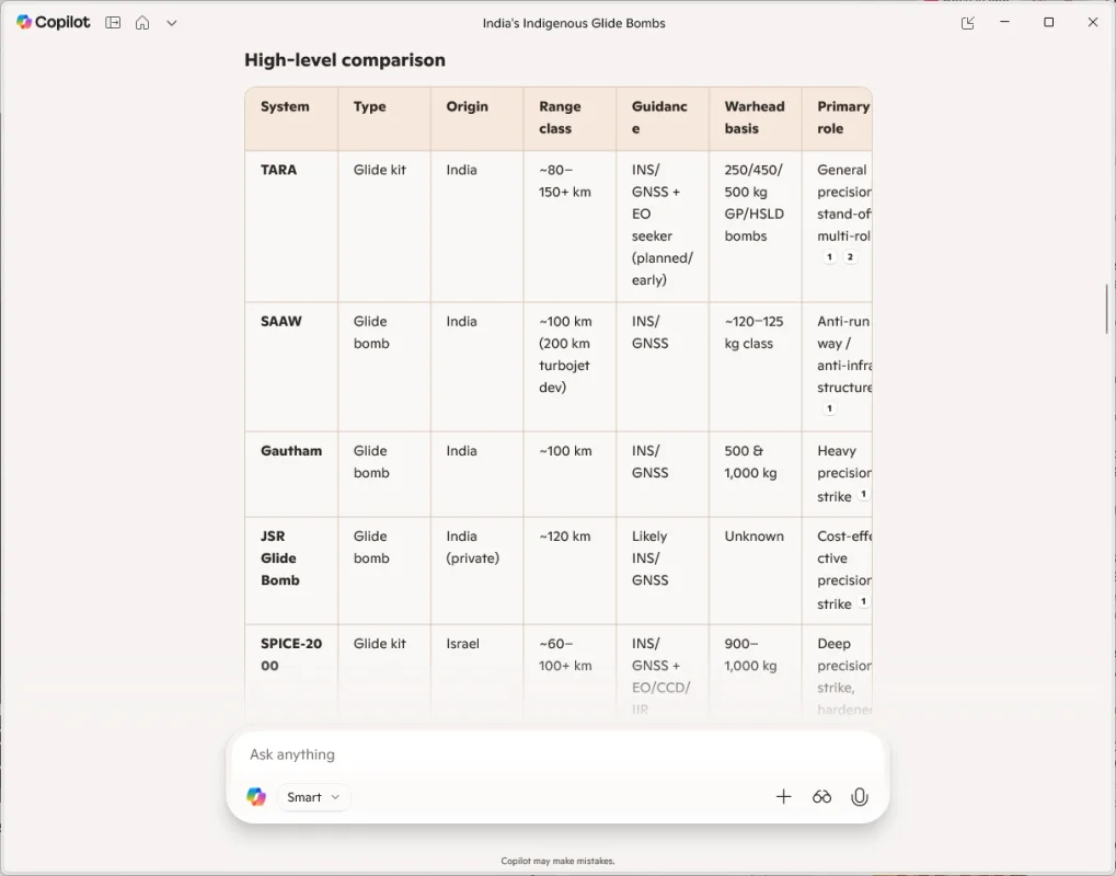

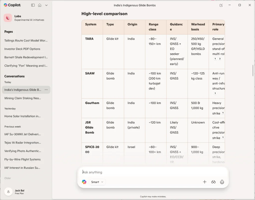

If you want to go even more granular, I can:
  • Sketch notional strike packages (e.g., Su‑30MKI loadouts mixing TARA + SAAW).
  • Compare cost‑per‑delivered‑kg of explosive for TARA vs SPICE‑2000 vs a typical cruise missile.
