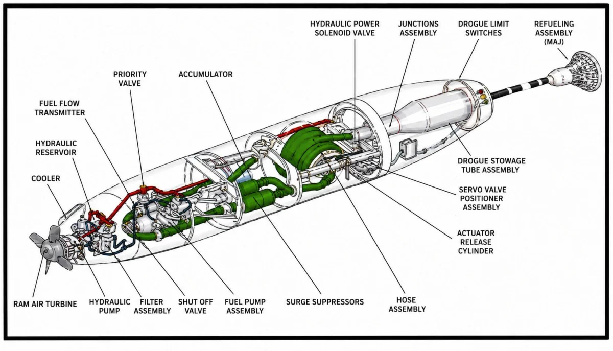

According to the tender's framework, the proposed system will be highly modular. A standard tanker configuration will feature up to three refuelling pods: two mounted on the aircraft's wings and an optional third pod attached to the fuselage.
Fuel will be drawn directly from the host aircraft’s internal tanks, and the entire transfer process will be managed by a dedicated technician from a central control station inside the plane.
Technical specifications indicate that the new pods are designed to operate flawlessly under dynamic flight conditions at altitudes ranging from 10,000 to 40,000 feet.
The system is expected to deliver a robust fuel transfer rate of up to 2,000 US gallons per minute.
To achieve this, the pods will utilize the traditional "hose-and-drogue" refuelling method, ensuring compatibility with the Indian Air Force’s (IAF) current fighter fleet and matching the methodology used by its existing Russian-origin Ilyushin Il-78 MARS tankers.
