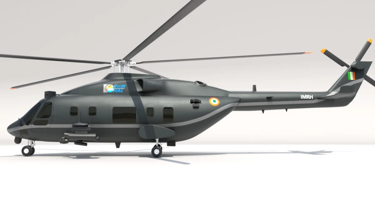

India's primary aerospace and defence manufacturer, Hindustan Aeronautics Limited (HAL), is introducing a major design change for its upcoming Indian Multi-Role Helicopter (IMRH).
Moving away from the hingeless rotor systems seen on its earlier models like the Advanced Light Helicopter (Dhruv) and the Light Combat Helicopter (Prachand), HAL will use a five-bladed articulated rotor for the IMRH.
This new approach is necessary to meet the demanding load and performance standards required by a larger, 13-tonne medium-lift helicopter, which operates much differently than lighter utility or attack aircraft.
Currently under development with a target of over 75% indigenous content, the IMRH is expected to be powered by the newly developed "Aravalli" turboshaft engine, created through a joint venture between HAL and France's Safran Helicopter Engines.

Built as a modern replacement for the ageing fleet of Soviet-origin Mi-17s currently used by the Indian Armed Forces, the IMRH is a 13-tonne class machine with an expected internal payload capacity of around 4,000 to 4,500 kilograms.

Furthermore, stepping up from the four blades used on the Dhruv to five blades on the IMRH provides a much larger overall surface area.
This extra wing space is crucial. It allows the helicopter to push enough air downward to lift its massive weight without forcing engineers to build an impractically wide rotor system.
By adding that fifth blade, the total span of the IMRH's rotor can be kept to a manageable size of roughly 21.2 metres. The additional blade also shares the physical burden more equally across the entire system.
