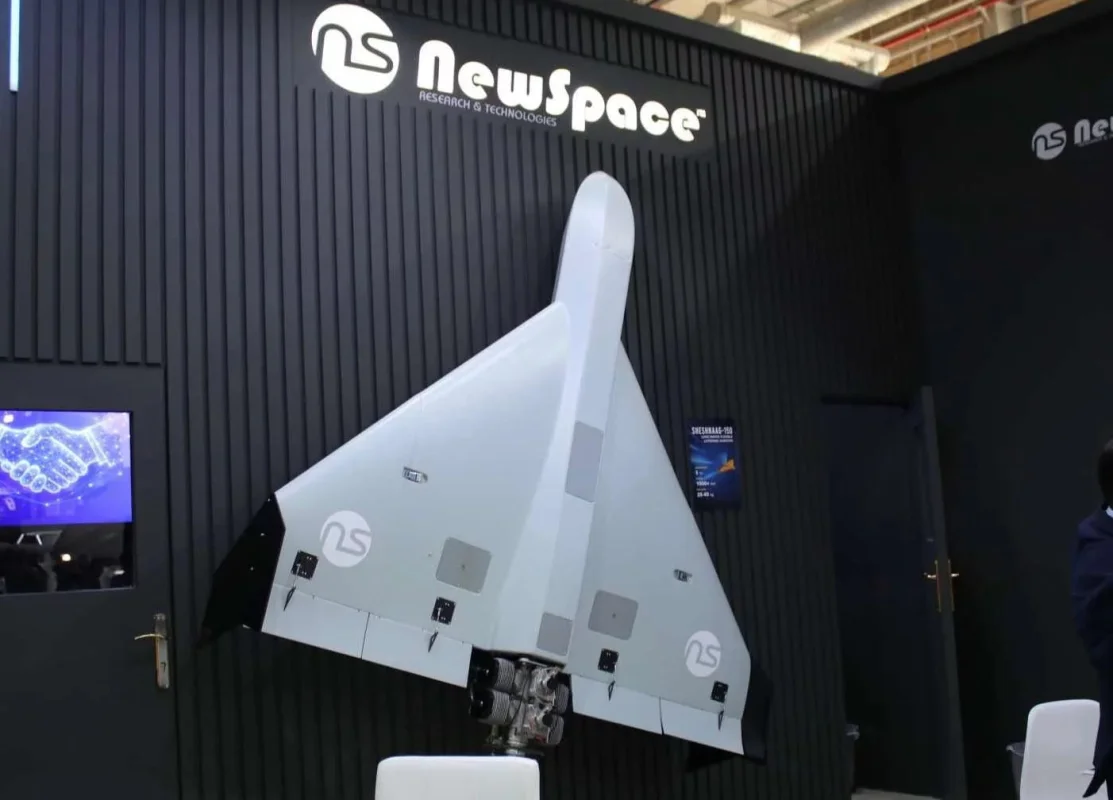

Developed by Bengaluru-based NewSpace Research and Technologies, the Sheshnaag-150 long-range loitering munition has recently drawn significant attention following its detailed public debut, most notably at the World Defence Show 2026 in Riyadh.
While its impressive operational range of over 1,000 kilometres is a major talking point, defence analysts are equally interested in its power plant.
The system is driven by a four-cylinder, horizontally opposed (boxer) air-cooled piston engine, which is a setup more commonly found on larger tactical unmanned aerial vehicles (UAVs) such as the Heron and Searcher.

An easily identifiable aspect of this engine is the large cooling fins visible on all four cylinder heads, clearly marking it as an air-cooled system. This is a highly practical choice for operations in extreme, high-altitude environments.
By completely removing heavy and complex liquid cooling mechanisms—such as radiators and fluid lines—the design inherently eliminates the risk of coolant freezing in the sub-zero temperatures of the Himalayas.
Consequently, this simplified architecture ensures robust dependability in the field and significantly lowers the maintenance burden for frontline defence forces.
A close look at the components mounted on top of the engine points toward the integration of either a high-grade carburettor or an electronic fuel injection (EFI) setup.
Such technology is vital when flying at altitudes above 16,000 feet, where the air becomes exceptionally thin.
Specifically, an EFI system provides the ability to constantly tweak the air-to-fuel ratio in real-time.
This guarantees that the engine burns fuel efficiently despite extreme fluctuations in temperature and altitude, thereby securing consistent power, maximum fuel economy, and prolonged mission endurance over harsh landscapes.
