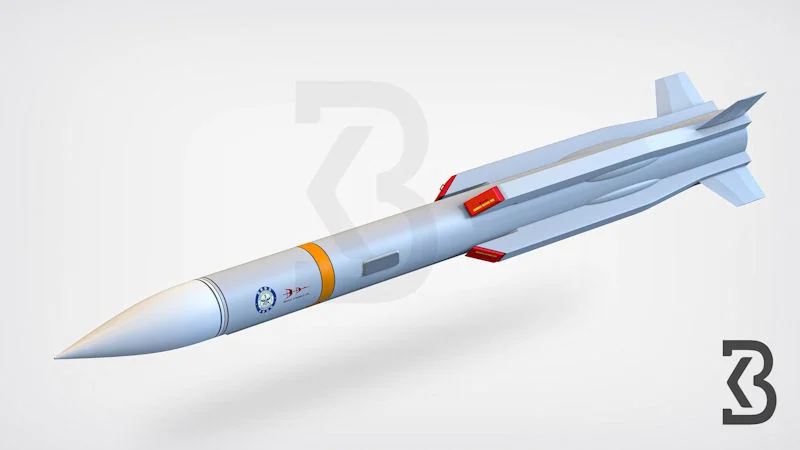

The Defence Research and Development Organisation (DRDO) has spent several years designing, testing, and building components for its Supersonic Target (STAR) missile.
Despite these ongoing efforts, this domestically produced, ramjet-powered system has yet to complete an officially confirmed flight test.
Consequently, a crucial programme meant to strengthen India's military capabilities remains in the testing phase, while other newer projects using similar technology are making faster progress.
The Purpose of STAR for India's Armed Forces​
STAR is built to be a reusable, home-grown supersonic aerial target. Its primary job is to mimic the flight patterns of modern anti-ship cruise missiles and high-speed attack aircraft.
By doing so, it provides naval and air defence teams with a highly realistic and affordable way to practice interceptions, reducing the need for costly foreign training drones.
The missile relies on a two-stage propulsion system: a solid rocket booster for initial lift-off and a Liquid Fuel Ramjet (LFRJ) engine for sustained high-speed flight, similar to the technology used in the BrahMos missiles.
Open-source data indicates that STAR can reach speeds between Mach 1.8 and Mach 2.5, operating at altitudes ranging from 100 metres to 10 kilometres, with an operational range of 55 to 175 kilometres.
It is designed to perform sharp turns and sudden altitude drops, accurately simulating dangerous threats like the Exocet or Chinese anti-ship weapons.
